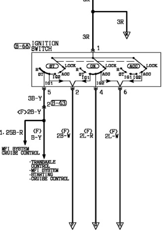

My question is, what are likely candidates for causing these momentary current spikes. Clearly this isn't a simple constant short to ground. Any ideas? The wire with the 17A intitial spike is feeding the distributor assembly and the fuel pump. Those are two prime suspects for me, though I don't feel comfortable enough with the process to understand why they'd spike quickly and drop down to manageable levels. Additionally, the starter wire that's drawing an initial 25A seems excessive...not leaving much overhead. Could the problem be in that direction?
As I understand the wiring diagram, both the wire going to the ignition/fuel system and the wire going to the starter are powered simultaneously when the key is in the START position. Minus the spikes, the amperage is manageable. What's causing these spikes? And how do I determine the answer to that question?

This may be an unpopular opinion, but I'm not sure I'd worry about the initial spikes of current :dry: With how momentary the spikes are, I really don't think the fuse has enough time to heat up and burn before the current draw drops.
No offense meant here, but I think it's interesting that the short went away when you disconnected the ignition switch and started testing. Any chance that the blue/yellow wire was rubbing ground somewhere on the column beforehand?
EDIT: Diagram incoming

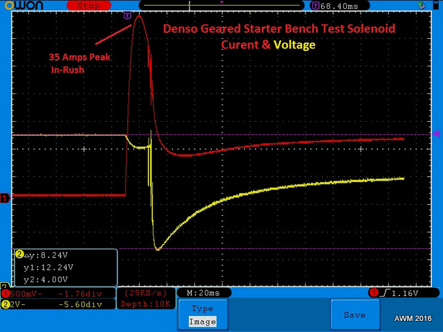

A huge spike in the starter solenoid coil current is normal I did some off car testing a few months back on 3 different starter motors and a spare solenoid coil and was really surprise at just how high the spike was about 35 amp for 2ms, then it falls back to about 10amps.
The same goes for the fuel pump, spike at key on then fall back as soon as the pump motor starts to run --- but the spikes would not normall overlap ie. first the pump spike then stater solenoid spike..
