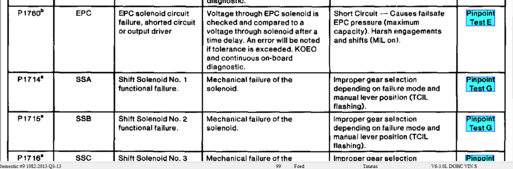

I have a 1999 Ford Taurus with the 3.0 (vin s) that intermittently will have the OD Off light flash and the car will from time to time shift crappy. No check engine light but I was able to scan it and the TCM has a P1760. Many times the light will flash but the car drives fine. Light will come on sometimes when in park but most of the time the car needs to be in gear. I have not been able to locate a good code definition or code set criteria.
I'm looking for some direction.
7 years 5 months ago - 7 years 5 months ago #23999 by Paul P.
I do believe that is for an EPC solenoid in the tranny
Electronic Pressure Control
This tranny will default to high line pressure, hence the harder shifts.

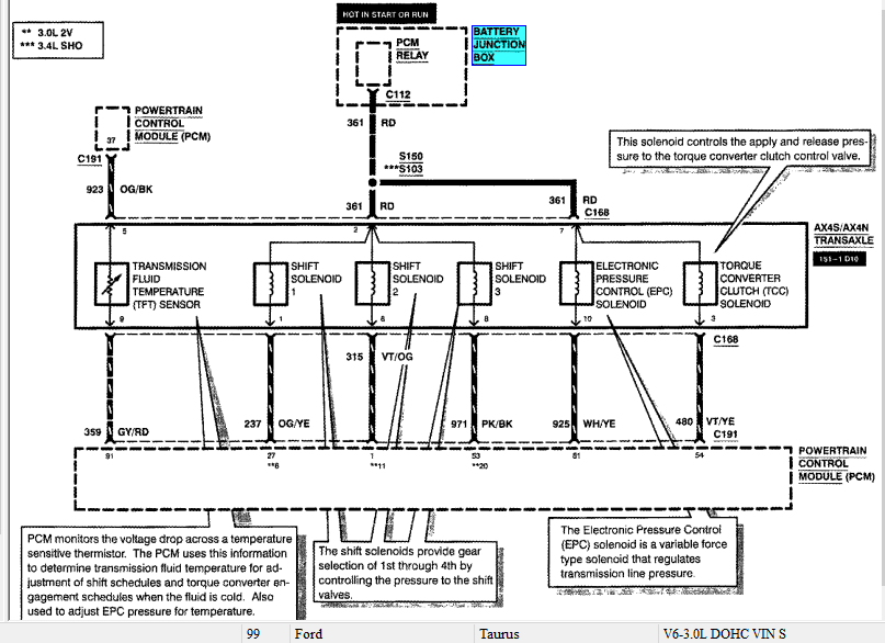

The wiring diagram shows the SOL gets it 12volts(B+) from the PCM relay. This Relay feeds mutliple other things. The PCM provides the ground path to energize the SOL. This is a ground side switched output solenoid. It is also Pulse Width Modulated(PWM).

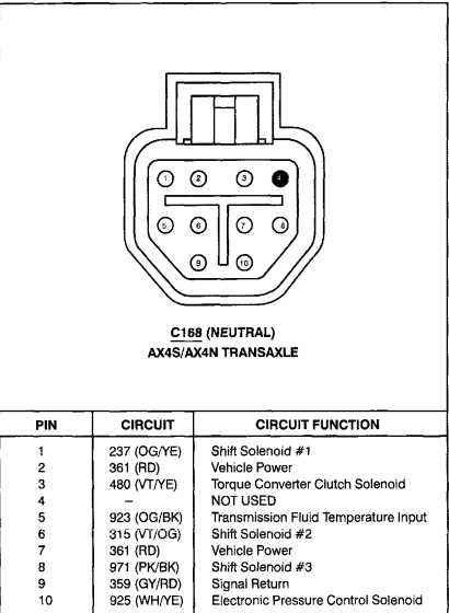

KOEO, Connector C168 Plugged in.(Back-probing)
1.Check for B+ at Pin 7 (Red Wire) and check voltage level at Pin 10 (White/Yellow tracer). You Should have B+ on both the PWR feed(Red) and the control wire(WH/YL).
2.Now unplug the Connector(still Back-Probing), there should be B+ on the Pin 7 and Zero on Pin 10.
If either of these two conditions aren't true, Post your results.
EDIT. These above 2 checks will quickly determine if there is a PWR feed issue, OR if the solenoid is OPEN.
If any of these conditions are not true, then the diagnostic strategy will change.

7 years 5 months ago #24054 by Paul P.
U should have 11.4 v on the wh/yl while connected. You have 8v. thats a 3 volt drop across the the solenoid. Not good. Possible Shorted Solenoid.
Now, I would go after the control wire to make sure its good, because unplugged you stated there was 1 volt on it.
Unplug the Wt/yl at the trans connector and the pcm. Check for voltage, you should have ZERO. If you still see voltage, there is a short to voltage.
While unplugged you can also try an OHM check, i think I stated the spec already.
Now, lets check the driver in the PCM. Backprobe the wh/yl at the trans connector. Attach test lamp to B+, start the vehicle. Touch test lamp to backprobe, the lamp should do some flashing, pulsing.
Be extremely careful that the test lamp does not touch ground.
Flashing, pulses means the driver in the PCM is good.
Sent from my SM-G930W8 using Tapatalk
