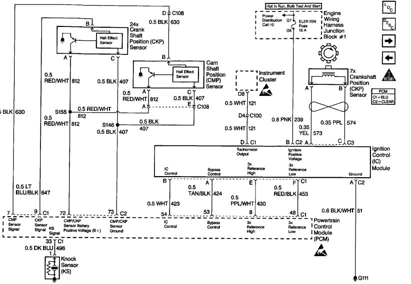

8 years 1 week ago #19288 by Paul P.
Replied by Paul P. on topic GM 3100, No spark!!
There is a Purple/White wire from your Ignition Control Module(ICM) to the PCM. This is the 3X High Reference used by the PCM to Calculate Crankshaft Position and Speed as well as trigger the injectors.While cranking the engine over, Tpin this wire at the ICM and place your test light on Battery Negative and the other on the Tpin. You should see flashes as the engine rolls over. If you don't the problem is either the ICM itself or the 7X CKP sensor your having trouble with.
You should also check your By-pass Wire for Voltage(5v) while cranking.(Use a test light again connected to Battery Negative) It's the TAN/BLK wire out of the ICM which goes directly to the PCM.
While the engine is cranking(not Running) the PCM applies 5v to the ICM, this voltage is turned off by the PCM once the engine is running At which point the PCM takes over Ignition Spark and Timing.
Hope this Helps you Out

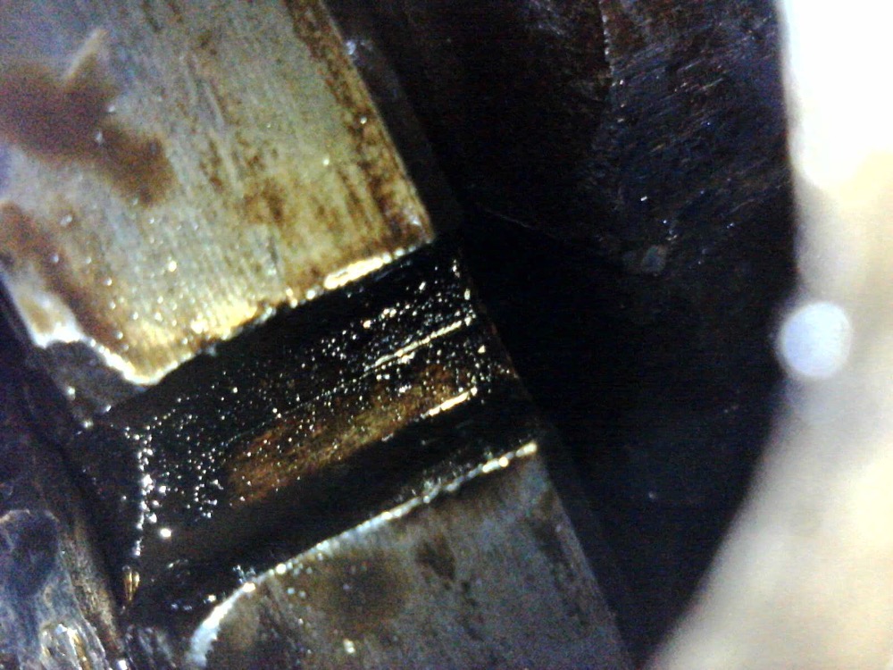

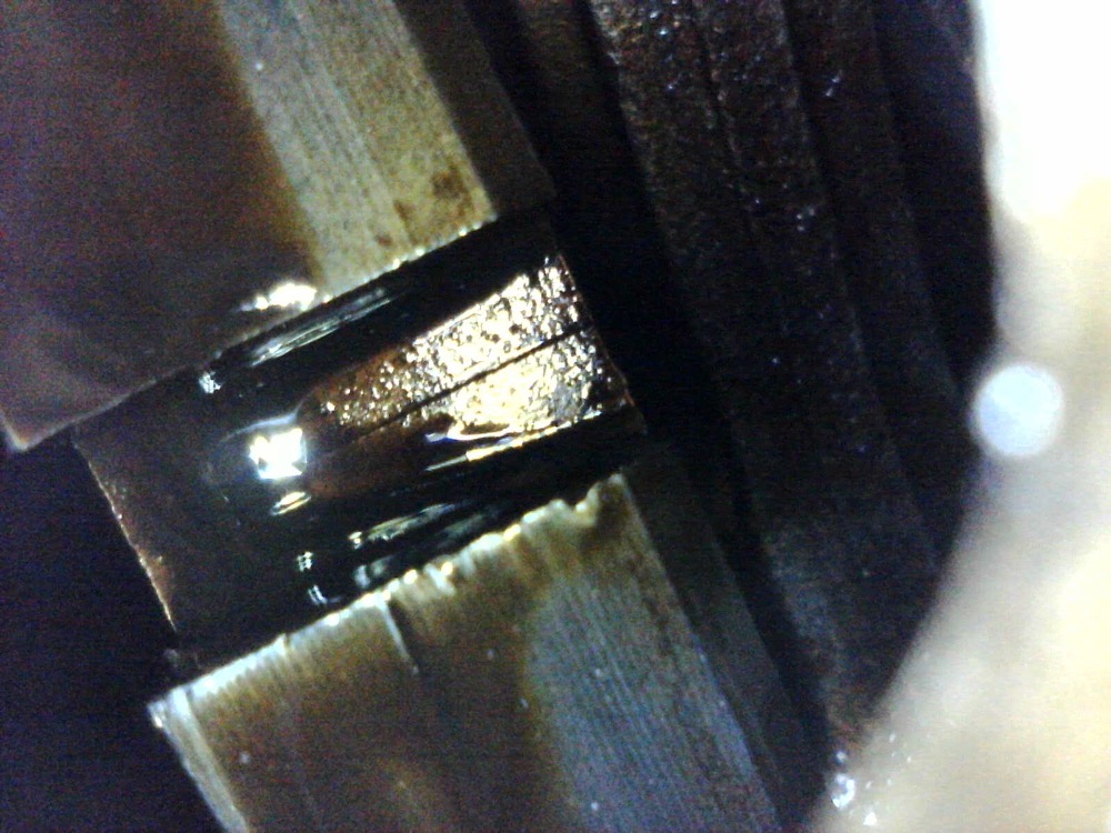

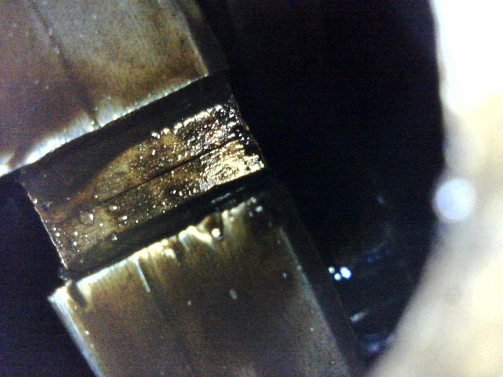

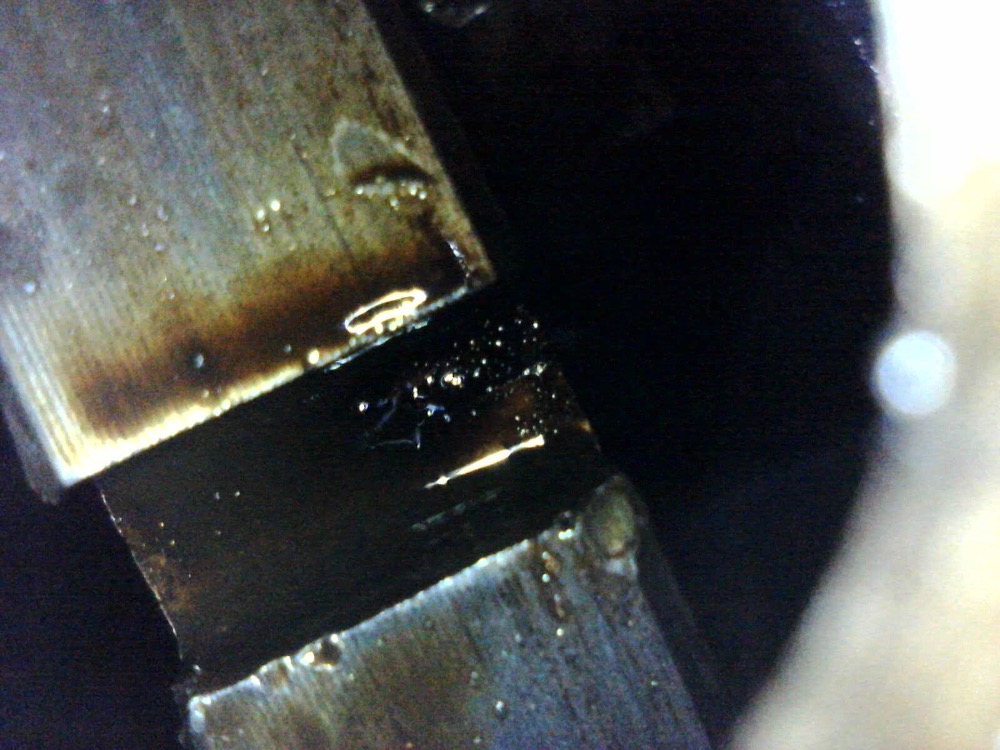

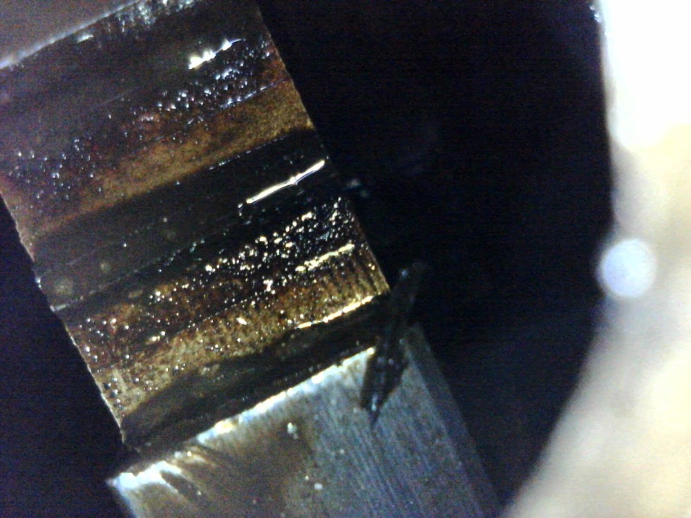

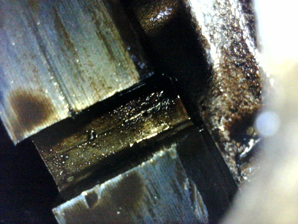

8 years 1 week ago #19306 by cdakan841
Replied by cdakan841 on topic GM 3100, No spark!!
Ok so I got home from work this morning and I threw the 2nd new crank sensor in (this one from Autozone) and still no spark!!! I’m beginning to pull my hair out!! I have a voltage signal just like the last crank sensor but no spark, and I can still bypass test it ans make it spark! Any more suggestions??? I’ve attached borescope pictures of each notch on crank sensor, I know one of the notches looks a little messed up but that shouldn’t cause a no spark condition would it??? I am beginning to think maybe something internal??? I hope not but i don’t know what else it could be!!! Thanks guys!!
8 years 1 week ago #19308 by Ben
Replied by Ben on topic Re:GM 3100, No spark!!
If you plug the sensor in to the harness and wave a wrench or something metallic past the sensor does it spark? My thoughts are that maybe the air gap between the crank sensor and the tone ring is to big you can measure the depth of the tone ring from the case and comparing it to the length of the crank sensor.

Ben wrote: If you plug the sensor in to the harness and wave a wrench or something metallic past the sensor does it spark? My thoughts are that maybe the air gap between the crank sensor and the tone ring is to big you can measure the depth of the tone ring from the case and comparing it to the length of the crank sensor.
Ok so I tried this this evening and it worked, I could make it spark waving a screwdriver in front of the crank sensor. So what would cause an air gap issue with the tone ring? I didn’t measure the gap but it can’t be off by much because I’m getting a voltage reading from the sensor. Both of the new sensors went in all the way and I tightened the bolt down with a 1/4” ratchet. I can’t get my head in there to see but it doesn’t feel like there’s anything behind it that would stop in from going in all the way. Could the tone ring be messed up on the crank?
8 years 1 week ago #19353 by Ben
That's my thought maybe the tone ring is bent can you get something in there to measure the distance from the ring to the mounting on the case and compare it to the mounting tab to the tip of the sensor?

Ok so I just watched a video on a tear down of this engine, the tone ring is part of the crank, so if it is indeed a damaged or bent tone ring I would have to replace the crankshaft in order to fix this. I will not be doing that, I will just swap another 3100 into it. I will try and get a measurement tomorrow on the depth of the sensor but it still amazes me how I can have a voltage reading coming from the crank sensor but it’s not enough to make it spark??? That to me just seems wrong??
8 years 1 week ago #19365 by Ben
Well with a large gap it's possible to get a voltage but when it's not a clean square wave the computer can translate
  • juergen.scholl
  • juergen.scholl's Avatar
  • Active partschanger
8 years 1 week ago - 8 years 1 week ago #19382 by juergen.scholl
Replied by juergen.scholl on topic Re:GM 3100, No spark!!
The 7x is a VR sensor, no square wave. The module translates this 7x into the 3x dignal and sends it to the pcm....
Try to get hold on a scope and see the actual 7x signature.
Did you check wether the crank sensor wires aren't inverted in the icm connecter???
